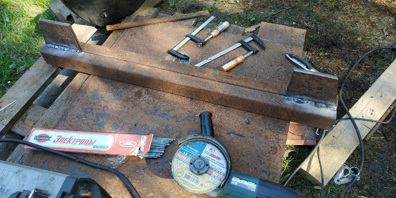

Steel beam in progress. It will be attached to the bulkhead by eight M10 bolts and nuts and also glued with epoxy. Under the step I'll attach a wooden spacer with epoxy.
I has used a lot of similar heavy loaded connections (wood or laminate + epoxy + steel plates + fastenings) on my previous boat and I am quite sure of its reliabilyty.
Erland
Inlägg: 13
Blev medlem: 14 dec 2016 21:59
Has thanked: 2 times
Re: A rotten mastbeam
Inlägg av Erland »
Hi
Class-rules says that the beam must be made of marineplywood. If you dont participate in races, it doesn't matter.
I wonder how you will make the beam fit against the underside deck. Will you use wood? Or are you going to use steel?
It looks like a good job. Looking forward to seeing the final result.
Regards Erland
