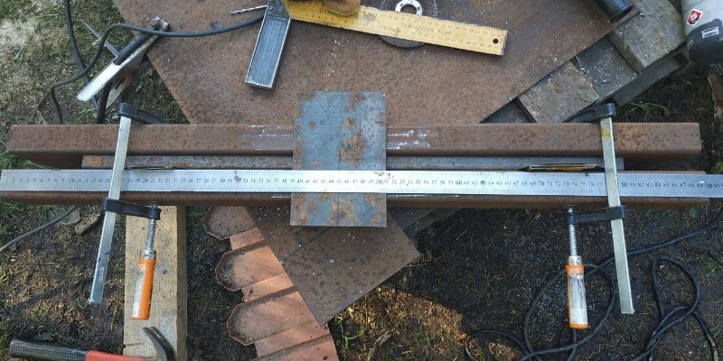

Steel beam in progress. It will be attached to the bulkhead by eight M10 bolts and nuts and also glued with epoxy. Under the step I'll attach a wooden spacer with epoxy.
I has used a lot of similar heavy loaded connections (wood or laminate + epoxy + steel plates + fastenings) on my previous boat and I am quite sure of its reliabilyty.
