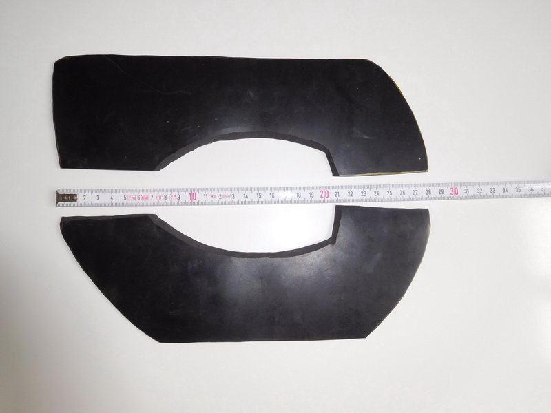

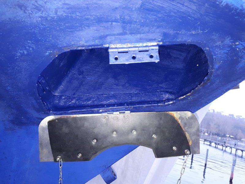

To make it, I took the original cover for the well opening, made a cut out in it and fixed two stainless steel half door on hinges. I glued the assembly in place with some rubber sealing paste. This allowed me not to make any holes in the hull. The doors are attached to 2 stainless steel chains and ropes running inside the well, so they can be opened/closed from the motor compartment.
The 2 half cut-out openings in the door are about 2 cm larger than the place needed for the motor axle to avoid any metal to metal contact. I fitted the inside of the doors with 5 mm rubber sheets that cover the space between the doors and the motor axle.
I must say that it took a lot of try an error to get the right design. But it was worth it. I now can take the motor out of the well in a matter of minutes (i.e. for Regatta or repair)

Hello Slag
Here are somme picture of the trap door!

Here is another series of pictures!
Second door fixed.jpg (66.7 KiB) Visad 27752 gånger
Rubber lining.JPG (100.57 KiB) Visad 27752 gånger
First door fixed.jpg (99.12 KiB) Visad 27752 gånger
Doors and lining.jpg (63.73 KiB) Visad 27752 gånger
