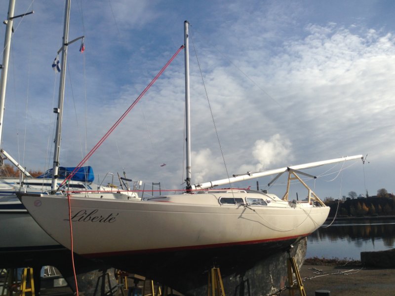

It very easy to up and down the mast.
My first experience of down the mast:
Attach the boom to the fore of mast. Connect staysail halyard to the nock of boom. The boom sheet will be used for control of down the mast. So connect it to bow cleat. To prevent the boom from falling to side, you must to use two lines from boom to the sides of hull. It is better to attach them in the plane of mast rotation. So when you will pull down or up the mast, the tension of these lines will be constant.
The same lines must be attached to the mast. It can be mainsail halyard and topping lift.
For the best result you can attach any balk across the hull in closest to mast place, and attach lines to this beam.

Är nyfiken på sättet Artsur tar ner sin mast
Men jag är kass på engelska.
Kan någon hjälpa mig med en svensk beskrivning?
Sen undrar jag hur han fäster bommen vid mastfoten?
Vill Artsur fixa bättre/närmare bilder?
