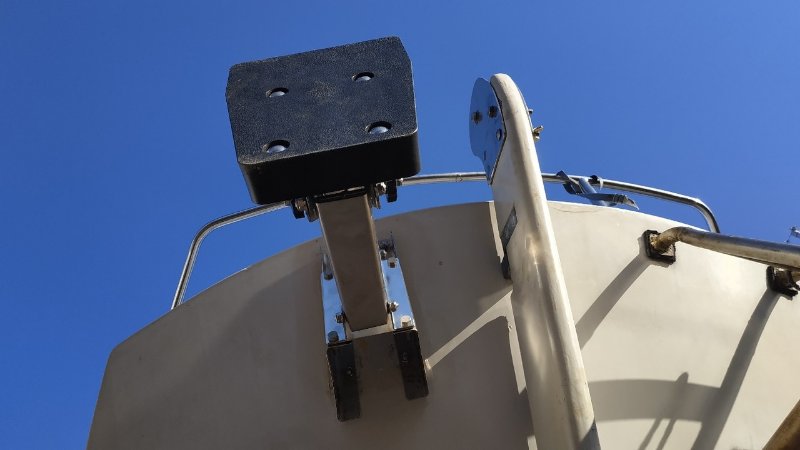

And installed a new motor bracket.

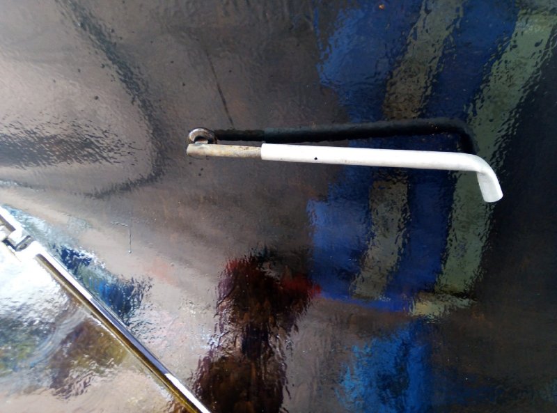

Inlägg av if1038 »
Oh yes, I did it! Even made a special wrench for holding a nipples during disassembling a valves. Installed a typical ball valves of leaded brass. And nothing was broken - the IF is ready for launch.
