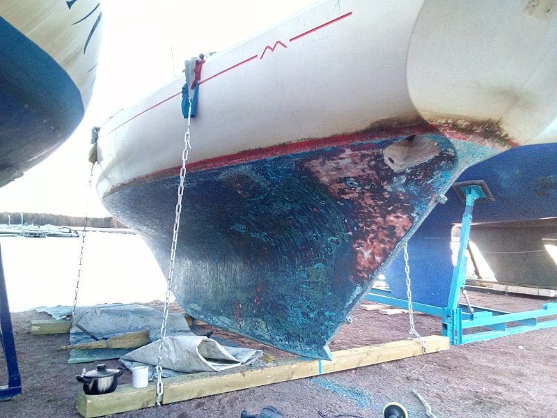

Hello! Sorry for my English)) This spring I bought IF 1038, 1972 in Goteborg. Now I lifted it after the trip and inspected the hull. It looks perfect, but I dont know, what have I do now? Is I need to grind old antifouling to gelcoat, or it could be better to leave the boat till the spring without any manipulations? In general, I meant to paint underwater part of the hull with the epoxy compound (or primer). But reading the forum, now I'm not sure with my next steps. Is anyone could to help me to decide, what I could do in nearest time? The IF is staying under open skies, and I not having a hygrometer to test laminate. Launching is planned to the May 2019, and then IF will be sailed in a cold and strongly salted water of Arctic Ocean.

Congrats to the boat and welcome to the forum!
If the underwater parts look fine and smooth and has no blisters I think you can leave it. Just paint new antifouling. But if the primer is still the original Polygrund (often dark red) and there are many years of antifouling on top perhaps you have better remove everything and start all over.

Oh, thanks)) Yes, it is really looking fine. And the old "Polyground" is still laying there - is I need to grind it off too? I planned to use any "hard" antifouling, which could to work for 2-3 seasons. In fact, in those waters, where I'll sailing, the fouling is very weak. And there I won't have an able to make a good repairs in next few years.

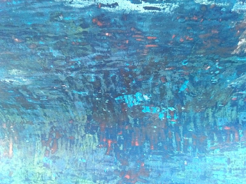

Oh! I brought home a rudder for the experiments
It have 6 layers of paint:
light-blue layer with soft mechanical consistence;
deep-blue layer - soft;
black layer - hard,
thin light-blue layer again, with undefined mechanical cosistence;
polygrund.
Maybe, it will be enough just to scrap off only 2 upper blue layers? Have you any ideas about the type of a hard black paint?

I am no expert on these things. But I think that the original red Polygrund primer is only a primer, i.e. it is not watertight enough. So when sailing in salt water you risk some water penetrating the glassfibre laminate and that can lead to osmosis blisters. The best cure is to remove the old antifouling and put on epoxi primer and new antifouling.
When I removed my old paint, I manually scraped off all antifouling with a paint scraper. Then I sanded the old primer to even out the marks from the paint scraper, which removed most of the Polygrund primer also. Finally I washed thorougly and let the boat dry outside all winter. In the spring I sanded a little again and then I painted epoxi in several layers, 3-4 layers I think, and finally some layers of antifouling. Be aware that it can't be too cold when working with epoxi!
It all depends on how you think the boat is now, and If you have the time to do the work.
I am sure others will add their points of view on the subject.

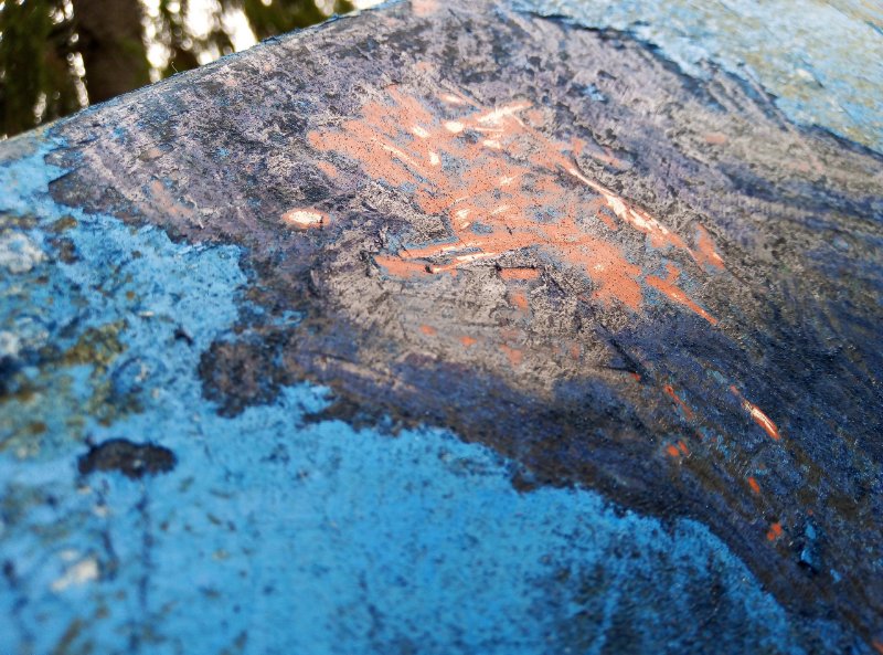

You will be laugh, but I find the best tool to fast and safe scraping upper layer... This is the most ordinary axe, used like a scraper.
5 minutes, and the rudder is ready to grinding. I found a couple of blisters under the paints, but I think, what this is not critical. Moreover - this is rudder, which always keeping wet, with water inside! I drilled the holes, recommended here.
In the end I think to leave the black paint as is, because it is very hard to grind off, and it staying very well on a grund. Also, I suggested to use an industrial vinyl-epoxy antifouling. But I still feeling doubts about barrier layer on a probable-wet laminate.

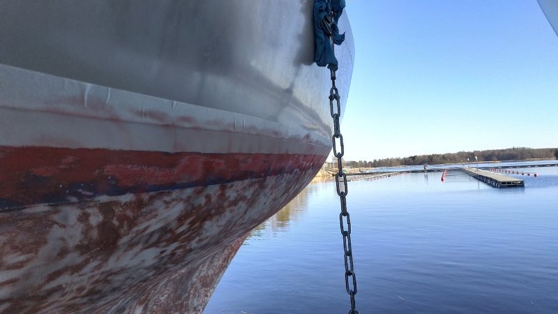

I'm started. Today I was scraped all the left board and I wasnt found there any osmosis or blisting. It's great!
I think, that "black paint" was exactly that "barrier layer". It have a perfect adhesion to the gelcoat, and it very hard to scrap. In short, I mean, that is not nessesary to totally remove it - just do matte, then cover with the epoxy.
I can't attach photos. If you intersted, you can look its here: https://vk.com/album240938277_256580246

I think you are doing well! If the black paint sits that hard, then leave it.
From the pictures I think you have made the right decision to renew the boat underwater painting.

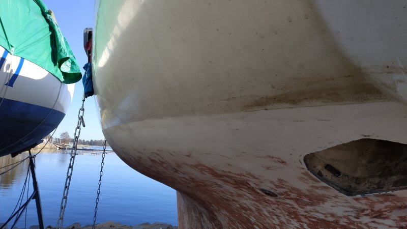

So, I grinded hull quickly for a few days and leaved to stay it naked during April. A dry and sunny weather is staying, and this qute perfect! Now is time to a final preparing for a painting
Also, I want to lift a waterline for a few centimeters up.
After a couple weeks I'll buy about 20kg of epoxy resin and some primer in the sales office of chemical factory, and then could to paint the bottom.

That looks good! I think it is clean enough for the epoxy painting. Those last old Polygrund primer rests wont have to be removed.
Follow the instructions for the epoxi resin. Wait for some days with good weather, so that you can paint the layers with the proposed settling time between. If you wait too long after one layer, you probably will have to sand before putting the next one on.
