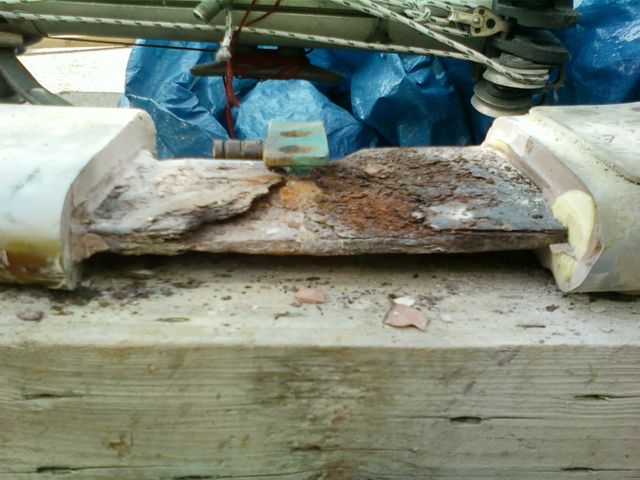

I'm new to the forum, and so very pleased to finally have this group to share and learn from. So... ahoy from Canada!
On to pressing matters. The rudder on my new (to me) Marieholm was cracked open at the top pintle, which is commonly remedied by installing an extended SS brace. However, the previous owner allowed the boat to sit with this opening in the rudder and time has led to severe corrosion. Any suggestion how I can salvage this rudder?? Otherwise I will shape a new rudder from wood. A quickish fix would be ok too, so that I can go sailing and leave the new rudder building for the winter months.

Oh dear, your rudder do look in a very bad state indeed.
I wasn't aware of there being steel inside the rudder. And what an irritating choice of material!

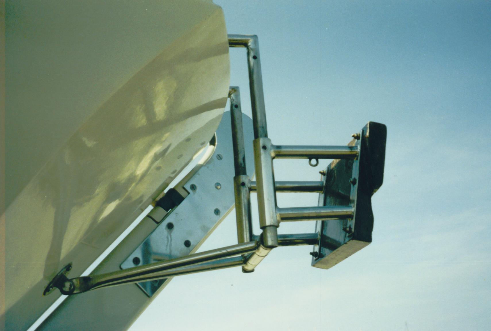

I put on longer stainless side plates on my IF-boat rudder many years ago, before the rudder had any crack. Although I then drilled new bolt holes further down, I am not sure what is inside my rudder. I don't remember the drill took any metal out.

My boat is an M26 built in Sweden in 1978. I am quite sure that all the rudders have a steel frame. It is a common design to fabricate a rudder with an SS insert and foam body. Here are some pictures of another much less severe repair.
I thought I might build it up with epoxy filler and layers of wetted out fiberglass. Sand it down, paint it and reinstall the pintle. Then have the new SS plates made to extend well below the repair, remount the rudder and go sailing. Any thoughts on this approach? How can I clean up the steel? I have never worked with metal, but Is there a way spot welding what's left? Is there a something I can apply to the steel to protect it from further corrosion before adding epoxy?

Yes, it is common to repair or reinforce the rudder by mounting longer plates at the top. I did that myself just to prevent any crack. Here is my boat:
I can't really see from your last two pictures that there is steel INSIDE the rudder.
In your situation I would try to clean the rust as much as possible and build up new glassfibre with polyester. On the both sides I would put such extended SS plates as in the pictures above.
To clean the rust off I think you can use a steel brush or have it sand blasted. Welding I'm sorry I don't know.

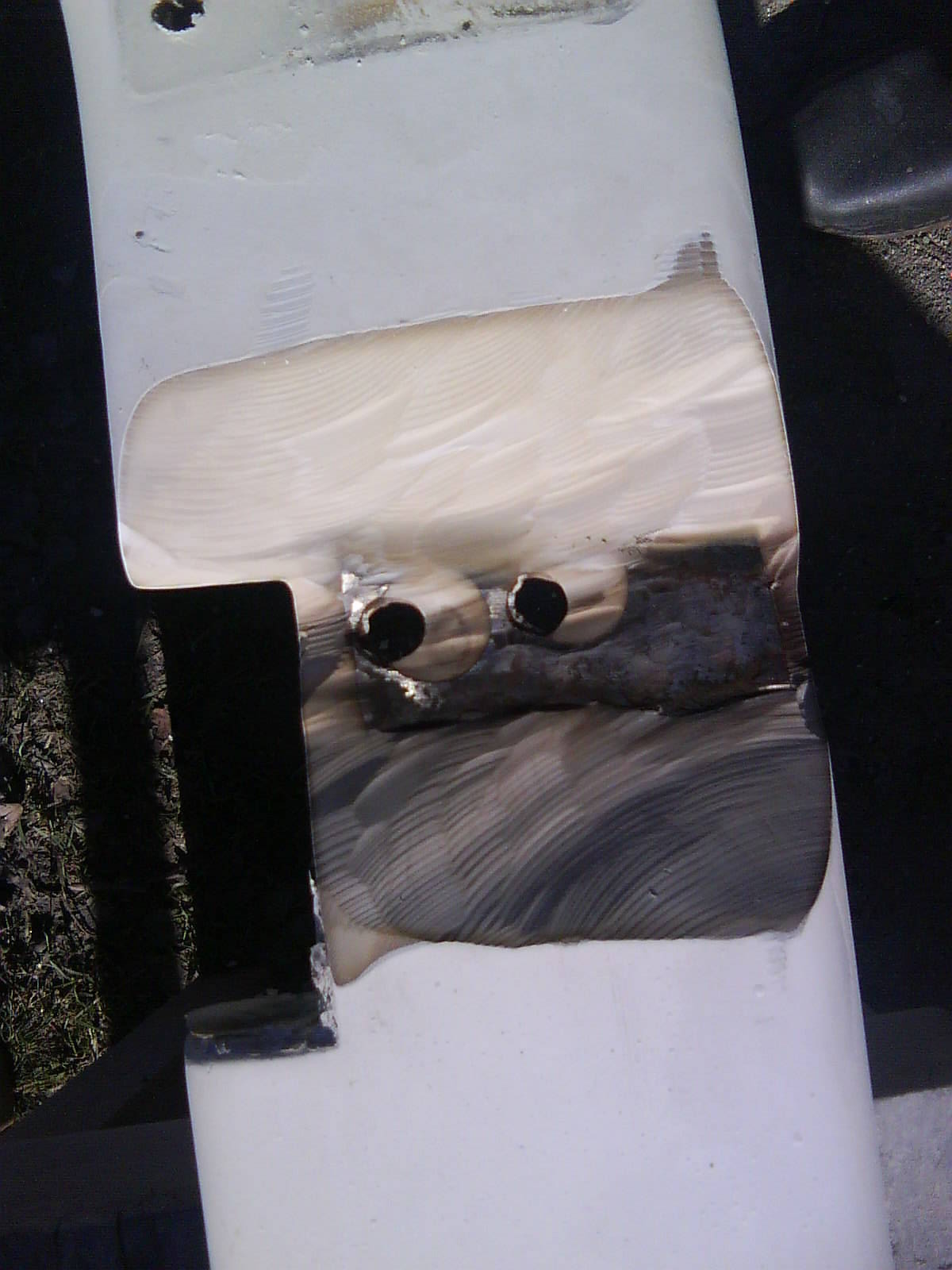

I see that you added a picture of my rudder, which is an M26 rudder with a steel core. I used an angle grinder to remove the rust and then used GRP to build up the rudder again. As I have understood, there are different types of rudders for IFs and for M26s. In my case the steel was in pretty good shape, so I didn't need to take strength into consideration. But I believe that a solution with epoxy and glass fibre would give enough strength.

Basically, I agree with Johan.
Before I realized that there was a steel core in my rudder, I was adviced to grind down the area around the crack so that the angle was something like 10:1 in order to get maximal adhesion to the plastic/steel and in order to distribute the forces to a larger surface. You should use cloth, as many layers as possible, as the cloth/epoxi together will replace the steel core. The filler should only be used to give a nice and even surface for the paint. Filler doesn't give any strength at all.
