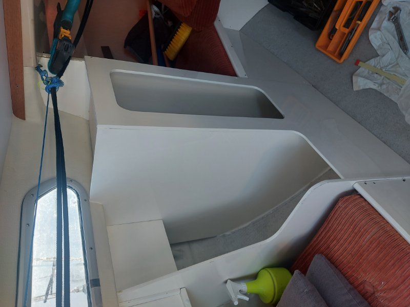

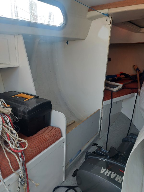

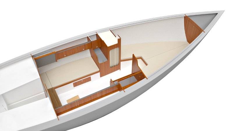

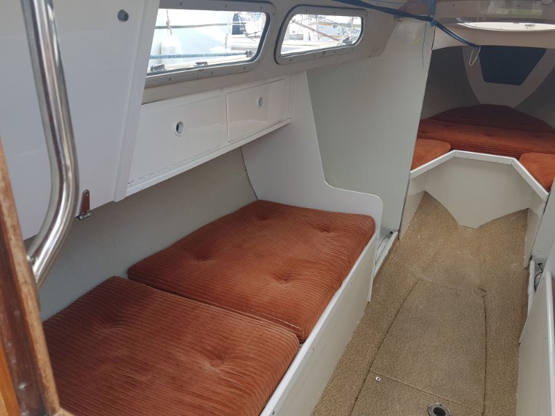

I have an adapted interior but know that a wardrobe must be present during competitions. I'm thinking of a panel that I put on during races, much like a picture shows.
Is this sufficient or should a side panel also be present.
I can also make a narrower panel with the same height but narrower.(Like the new IF)
The question then is whether a side panel is also needed.
I'd love to hear how it's done, vrgr Adri van de Velde

There has to be a wardrobe with a width of at least 350 mm. The wardrobe height must be at least to deck level and it must have a front with an opening or a door.
In my opinion your pictures show something that is not allowed. There is no front, the height isnt't enough and one side is missing. That is simply not a wardrobe.

Thx,

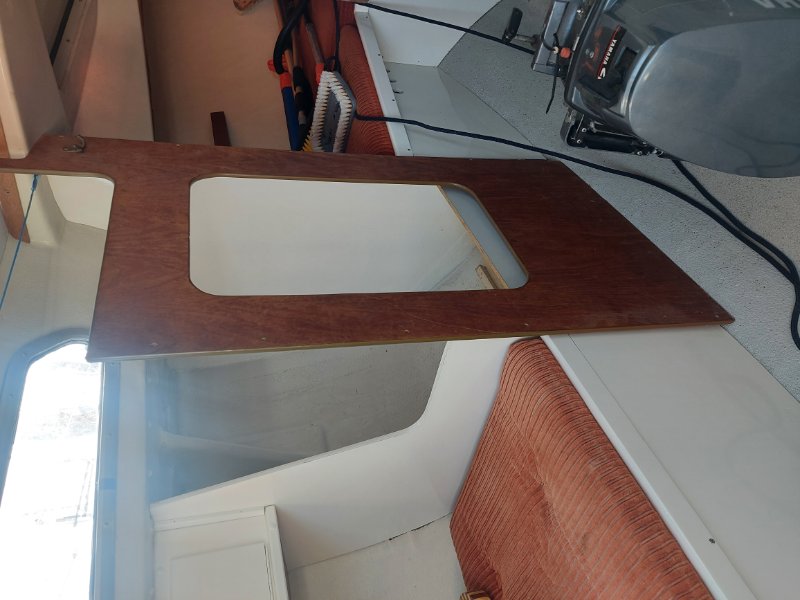

There is a picture missing of a kind of additional panel (the old one as an example).
Maybe this one is something?
or has it to have a side panel as well at deck level?
Otherwise, I can make a smaller (350mm) front panel to deck level with a side panel to the hull.
And put the whole thing behind the lower front panel that already exists, just during races.
Is that an idea?

Also add a top cover to make it a complete wardrobe or, alernatively, make the vertical panels higher so they reach the inside of the Cabiin ceiling.

Okay, I think I get it.
I will make a small (35cm) front panel at deck level with an opening and a side panel to deck level included a cover.
So that will be (more or less) as in the new IF from seacamper.
First I will make it demountable but when it looks not bad I can consider making it permanently
Many thanks for your help
I will have my IF as light as possible but within the rules for races
Reg, Adri van de Velde Spotgaai NED1417

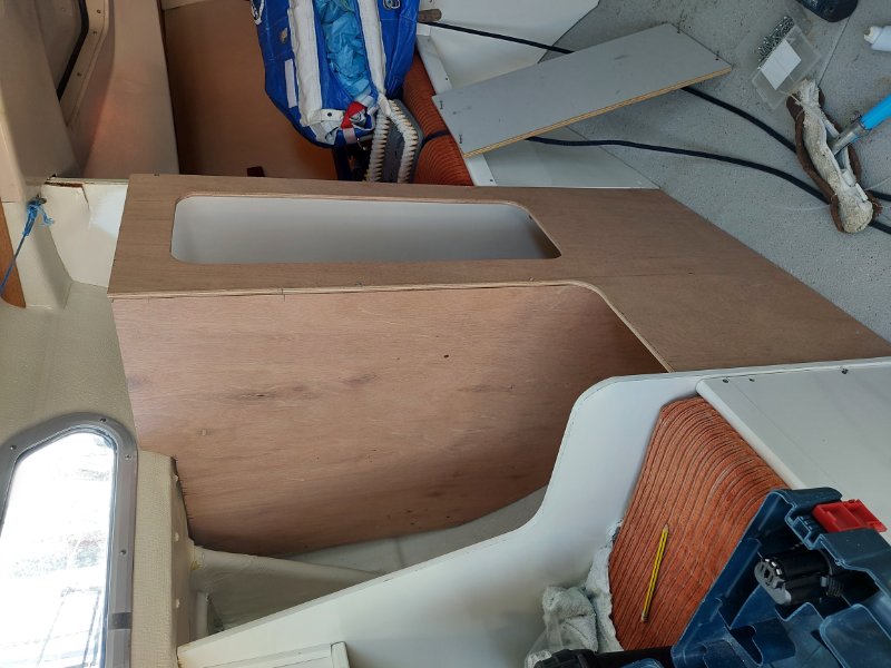

Re: Mandatory closets inside.
Next stage, on my way.
Better, right?

Looks nice. Do not forget the top cover .
(cannot be seen on the photo).

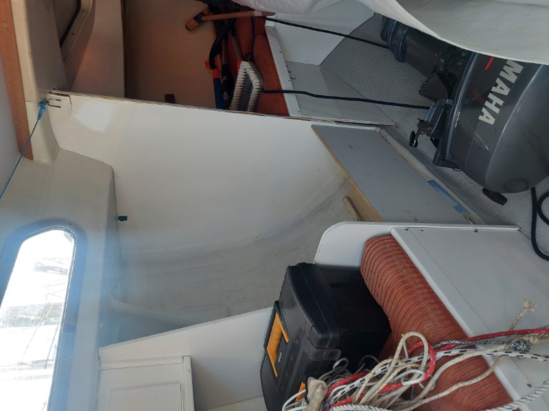

The result of some homework to make Spotgaai according the rules
