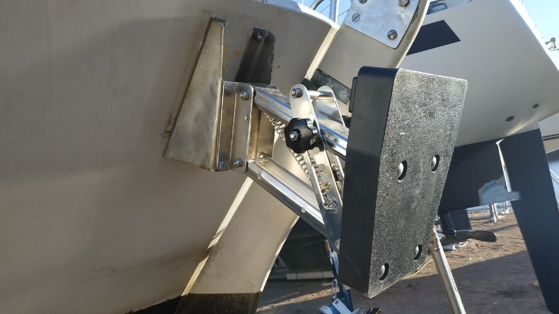

And installed a new motor bracket.
Now is only remaining to replace a cockpit valves before a launch. I afraid to broke (scuppers? seacocks?) on which its installed.
