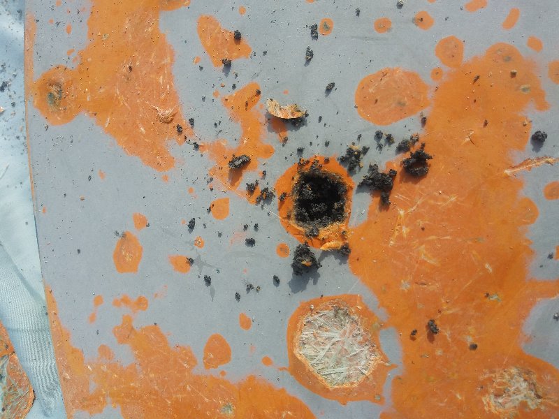

Today I realized that my rudder has bigger problems that I thought. All of it was full of water and the sandwich material completely gone.
I would like to check if any of you know a place where i can get a new or used one, all suggestions are welcome!

Re: Marieholm IF-E New Rudder
Oh, dear!
That is one bad rudder! I have never seen one like that. I wonder what has caused those holes?
You say there was water inside. Can it be that the water inside has been freezing to ice and expandning during cold winter?
Do we also see rust in there? It's hard to tell from the photos.
