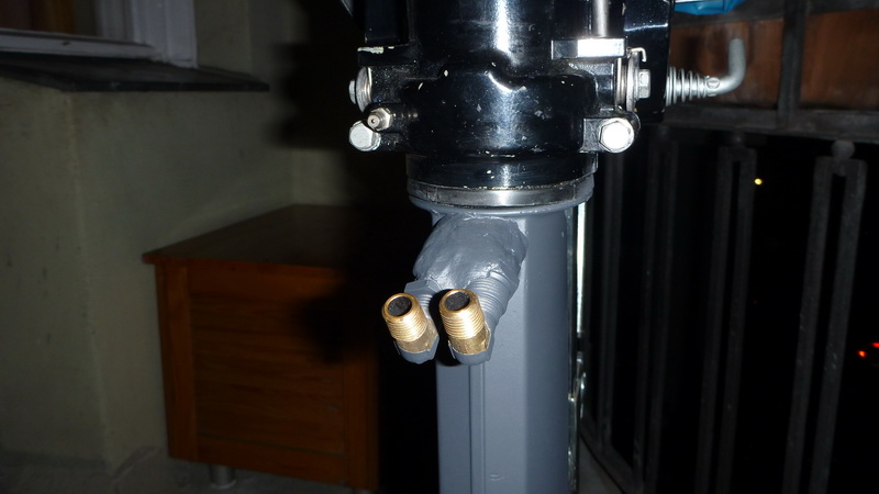

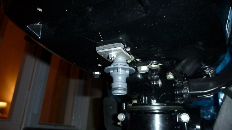

The previous owner of my boot had 3 very good solutions.
He fixed a tube under the control water jet outlet to eject the water at the rear of the boot
He fixed two metal fittings on the 2 smal exhaust outlets in the upper part of the shaft (glued with some kind of metal cement) and fixed a double plastic tube to eject Idle exhaust fume at the rear of the boot.
He used the holes that were previouly holding the external motor support, so he did not have to make any new holes.
He mounted a remote control (gas and gear), so he could control the motor without having to open the back door.
If you are interested I'll send you some photos

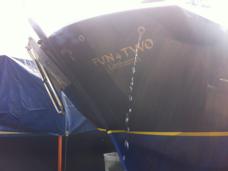

Here are some photos
You can see at the back of the boot (she is now in Berlin) the control jet water running (right) an the exhaust fume (left).
The control jet fitting is a garden hose fitting which has been widen to fit on the outlet (11 mm diameter) and is hold in place with a metal plate and a screw.
The 2 exhaust fittings have been glued with some kind of metal cement like this one (http://www.loctiteproducts.com/p/epxy_m ... ncrete.htm). They join in a single transparent plastic tube connected to the hull outlet.
Exhaust fumes are not very hot, most of it is expelled through the propeller, the upper exhaust is just for idle, when the pressure of exhaust gas is not sufficient to push it through water. Thus a normal plastic hose is OK.
I have head of a german sailor who joined the three tube together so there is only one outlet on the external hull for exhaust gas and cooling water. It might be worst testing.
