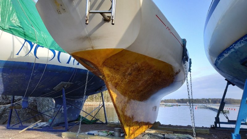

It was difficult, but I done it! That is all for the bottom. Now I need a little holiday. CL2irMkH92I.jpg sn-FFTYhaUw.jpg I think, antifouling is not nessesary for cold waters, where I planning to sail this summer. There are grows only a bit of seagrass like a green snots, which are easily cleaned ...

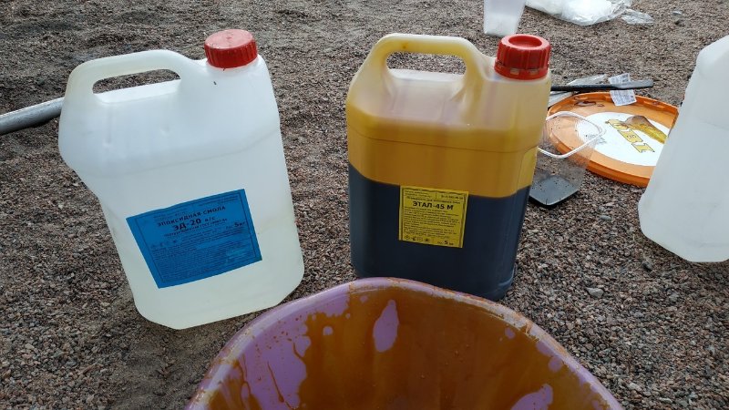

Oh yes! Just a 5kg of epoxy and a first layer is complete. And it didn't even need to mix any filler. The temperature was around +10C and the resin was quite viscous in its pure form. I'm tired to roll it out to surface.

So, I grinded hull quickly for a few days and leaved to stay it naked during April. A dry and sunny weather is staying, and this qute perfect! Now is time to a final preparing for a painting :roll: Also, I want to lift a waterline for a few centimeters up. After a couple weeks I'll buy about 20kg of ...

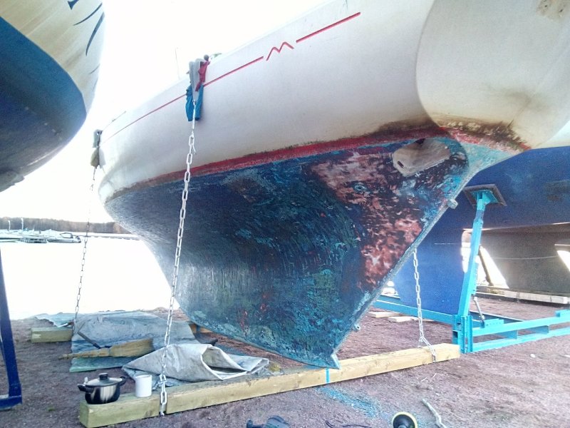

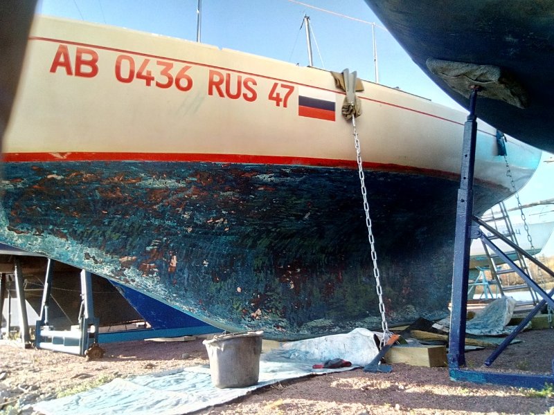

Hello again! :P Spring is coming, and I started to grind. In 8 hours total, I grinded off a half of boat. Later I'll grind a right half, and will waiting about a month. The technology of covering I see as follows: When the constant positive temperatures will established, I will wait for a few Sunny ...

I'm started. Today I was scraped all the left board and I wasnt found there any osmosis or blisting. It's great! I think, that "black paint" was exactly that "barrier layer". It have a perfect adhesion to the gelcoat, and it very hard to scrap. In short, I mean, that is not nessesary to totally ...
