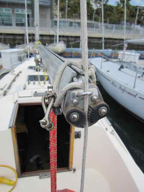

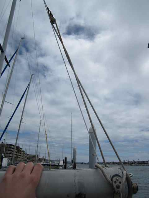

here's an example
Re: Boom topping lift at IF
Postat: 11 jun 2011 19:16
av skiziks33
topping lift.jpg (19.42 KiB) Visad 23957 gånger
the wire with the block is attached at the top of the mast just 10 cm below the masthead using a 2 screw clip blacket. admittedly, the screws made removing the masthead for antenna wiring more difficult. on end of the lifting line is tired to a clip on the side of the boom using a stopper knot, the other end runs through the an eye and jammer. make sure there is a stopper knot at this end as well.
